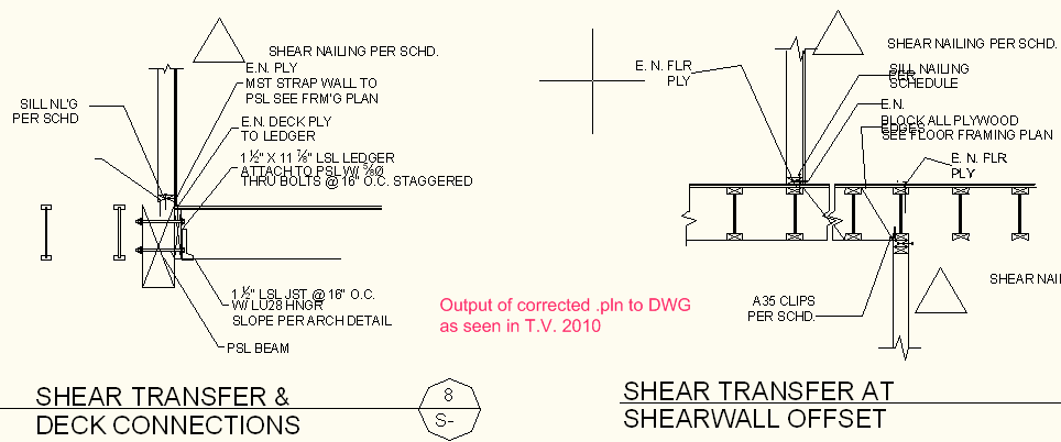

I'm working with a new engineer and he sent me some of his details.
I've imported his dwg with several const details into AC12(all current) and some (maybe 20%;more in the shown example) of the text is tilted at different angles.
So I selected the text, corrected the tilts made some basic changes to the
details (and all is fine and stays fine in the .pln) then saved as .dwg using the "Save for further editing" option translator and the newly created dwg has the tilted text again as shown below.
I don't have the shx fonts and have to say "skip all". Is that what's causing the tilting?
Or is there another known issue with dwg import/export text tilting?
I should add he's using ACad 14 and all the text looks correct on his screen.

I reopened the original .dwg in AC12 and noted that the length of the leader line did NOT correlate to the degree in which the LABEL was tilted.
So at least that variable seems to have been corralled.
The translator settings; “Custom>Label>Convert labels to Leaders IS and I believe was checked all along.
Screen shot of Original dwg from engineer as seen by T.V. 2010 below;
and Output to dwg as seen by T.V. 2010 in next post.

Semi corrected (other issues abound) output to dwg as seen by T.V.2010

Thomas Holm
lec1212 wrote:
...I reopened the original .dwg in AC12 and noted that the length of the leader line did NOT correlate to the degree in which the LABEL was tilted.
As always, the devil is in the details.
It's obvious that ArC and AuC treat these things differently.
– I guessed that the tilt, not length, of the closest leader line would correlate to the degree of tilt of the label text. I might be wrong. Your engineer could perhaps make sure that that line is untilted in a test file for you to import?
– What happens if you uncheck the Convert Leaders to Labels setting before you import to Archicad?
Hi Thomas
Well you sure are right that the "devils in the details".
One simple UNclick the switch and life is good on the range again.
You were right, it does not appear to be related to fonts.
Thanks for all the insight though, I think I have a little better idea now how to set deal with font issues in Acad>AC>Acad
It was; Translator>Settings in Selected Translator>Custom Functions>Save Extras>Label>and then UNcheck; Convert Labels to Leaders.
