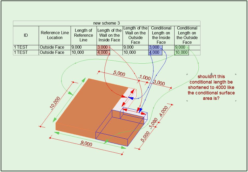

Now a look at the lengths.
Seems pretty straight forward but why isn't the 'Conditional' length reduced the same as the conditional surface area is?

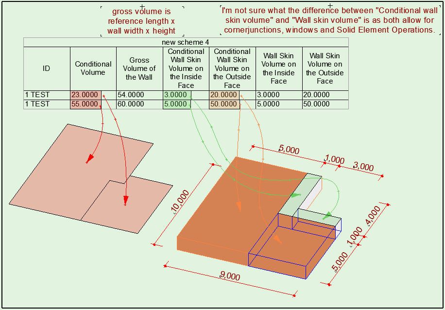

Finally the volumes.
The gross volume is the entire length of the wall x width x height so you will get a doubling up of volume at the corners because the junctions are not taken into account.
The 'Conditional' volumes do allow for the corner junctions and these will give accurate quantities as there won't be missing bits as with the conditional surface areas (the missing wall ends).
Again I am not sure about the 'Wall skin volumes' - I don't think these will include roof trimming where as I think the 'Conditional' volumes will.
This is all I have deciphered so far.
I am not happy with the inconsistency in the calculation methods for conditional surface areas and conditional lengths and that you can't get a true surface area for both sides of the walls.
Turning PBC off (i.e. turning 'Legacy Mode' on) will revert to the old method of mitring corners in 3D which will give better surface areas as the ends of walls will not be missing.
But you lose the benefits of PBC in the 3D model and sections.

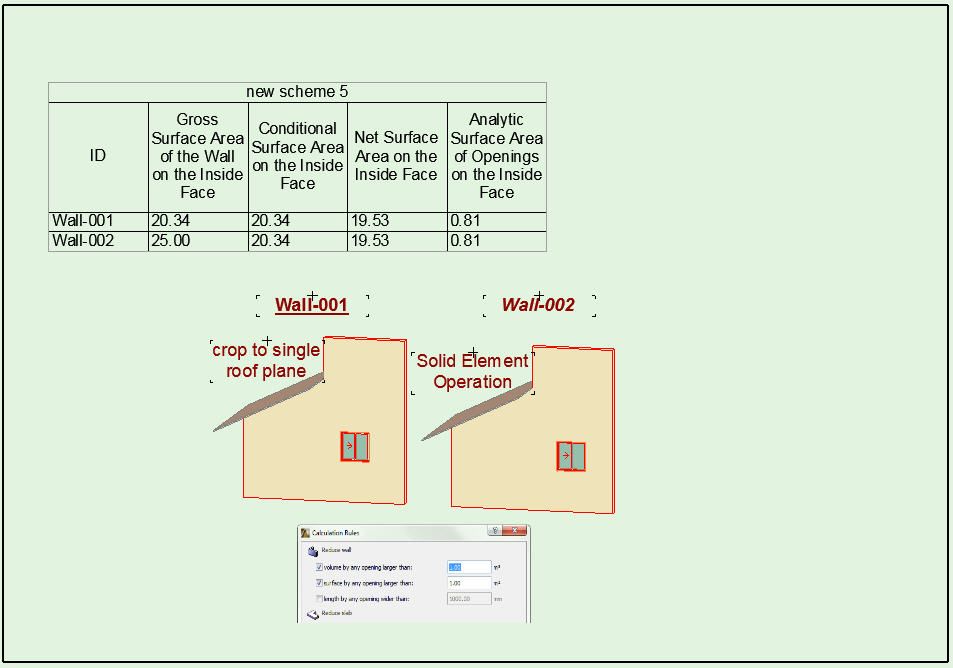

Barry wrote:
I am not sure exactly what the difference is between the 'Net' and 'Conditional' areas are. They both allow for corner junctions, windows and door openings, Solid Element operations. I think one won't allow for roof trimming.
The difference is that the Conditional takes into consideration preference settings when subtracting openings.
It will subtract the surface of any openings that exceed a given area as defined in Options > Project Preferences > Calculation Units & Rules Dialog, then Calculation Rules Dialog (“Reduce Wall surface by…”). The Net will subtract any opening regardless of its size, so it is unconditional in this regard.
Try to place in the wall an opening that is smaller than the size set for reduction in preferences. The Net should still subtract it, while the Conditional shouldn't because it is not a large enough opening.

Thanks for the explaination Laszlo.
It is as you said.
I forgot I had my window area tollerence set very small which is why I was seeing no difference.
Interestingly a 'Crop to Roof' will deduct from the 'Gross' area but 'Solid Element Operation' will not - maybe that is by design but that seems inconsistent to me.
