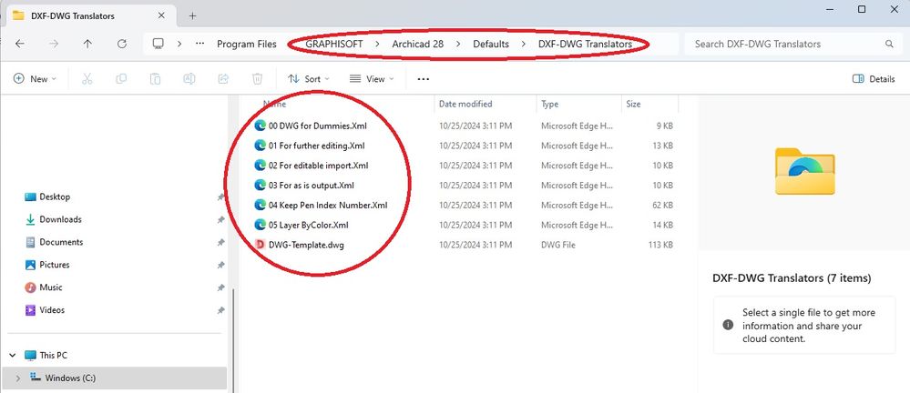

Can you check something out for me?  I use windows, so it'll be different for you in MacOS.  Can you navigate to the following location on your computer and let me know if you see all the .xml files in the DXF-DWG Translator folder?  If you don't see them there, you might need to re-install Archicad 28.  This is where I'd start though.

I did look for those translators and they were in place in 28 folder. DELETED 28 and re-downloaded the DMG. NOW the DMG keeps popping up with “Archicad.dmg is damaged and can’t be open” error so no more 28 for now, back to 27…. Tried downloading from both Safari and DuckDuckGo browsers.
