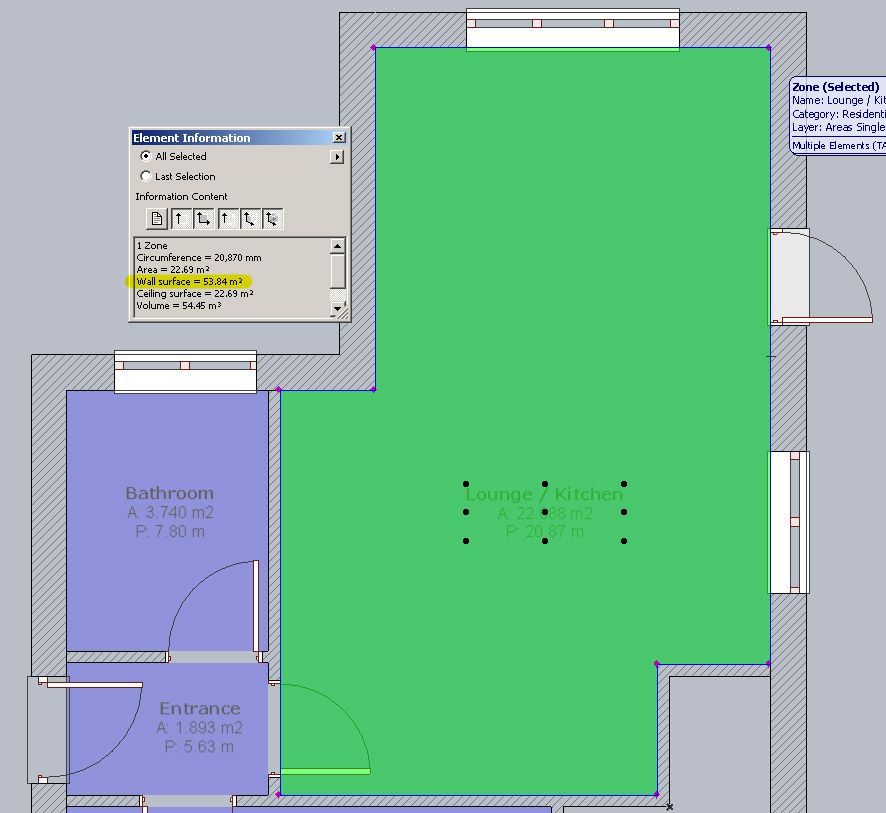

hi all,
i've been reading up on schedules/element info and zones but can't seem to get a particular set of data without some major workarounds.
there is a lot of info on this but i'm still not sure whether what i want to do is possible or not - apologies in advance if this has already been discussed.
i would like to do the following (please see attachment): for the highlighted zone (shown green) i select Element Information. The info is set up so it displays the Wall Surface (yellow highlight). I assumed that this number would be the area of the walls 'touching' (surrounding) the zone (based on zone level and height) less the area of all the openings, but after calculating the actual surface area, the result is very different. I also notice that if i change the Zone Height, the Zone Volume updates but there is no change in Zone Wall Surface.
So my questions are:
can i determine the surface area of the walls surrounding the zone (based on the level and height of the zone)?
how does Element Information calculate the Wall Surface area?
TIA
Hi Derek,
If you have used one of the auto-fitting zone geometry methods, and updated the zones to fit any wall editing - then any wall that touches the zone is included in the area value shown. The height of the zone does not affect wall surface, only zone volume.
Any openings that I insert subtract the correct amount of surface from the walls.
The wall surface issue is an interesting one now that we have had multistory walls in AC and the floor plan cut plane for a few versions. It seems to me that one might want an option to include only the surface that touches the zone. (In the 'old' days, a wall only showed up on one story, and so it could not be part of a zone on another story anyway.) Lacking this, it is too easy to accidentally include the same wall surface multiple times in a schedule.
Cheers,
Karl

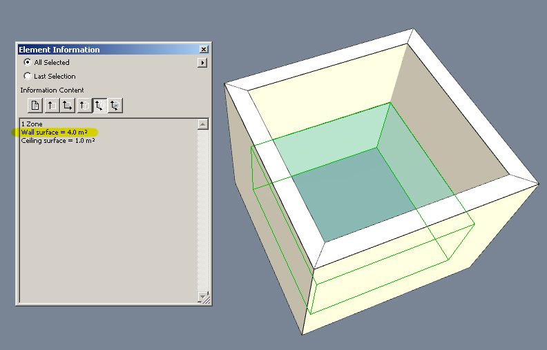

Erika, take a look at the attached.
i've made the example as basic as possible to make my point. there are 4 walls. each INTERNAL wall is 1m long x 1m high, so the total wall surface area is:
1m x 1m x 4 walls = 4m2
the zone i created is within the walls but is half the total height (the zone is 500mm or 1/2m high) so the surface area of the zone (sides of the zone) should be:
1m x 0.5m x 4 walls = 2m2.
however, as you can see, the calculated area is 4m2 - the total area of the walls touching the zone. this is the problem. AC does not trim the height of the wall to the zone. the same result comes out of the schedules. i used Element Info because it's quicker for this example.
even if i trim the walls to a roof which is at the same height as the top of the zone, the zone still calculates the total height of the untrimmed roof (see attachment in next post)
does it work for you?
even with trimmed walls, the calculated surface area is still 4m2. these walls are now only 1/2m high x 1m long so the toal area should be 2m2.
the UNTRIMMED height of the wall is 1m and this is the height used for calcs...
