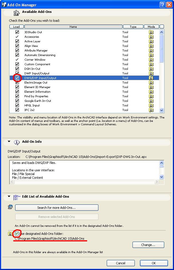

You're right. The DWF In-Out and the DXF-DWG In-Out options in my add-on manager both have a red triangle with an exclamation point in it. The message states "The file is an outdated Add-On that cannot be used with this ArchiCAD version."
Anyway to resolve this without installation disks? I'm on the road, with no access to them.

Sorry about that. I'm on version 10, running on Windows XP. I was still pointed at the correct folder, but I tried to reload them anyway. It didn't resolve the issue.

Do you have the latest version of AC10 (1183). If not, try updating it via the Help menu. You should have the Add-On Manager look like the attached image. Make sure the Add-On is ticked and is pointed at the AC designated Add-On folder. (It's not absolutely necessary to keep it like this, but may help in resolving your issue).
