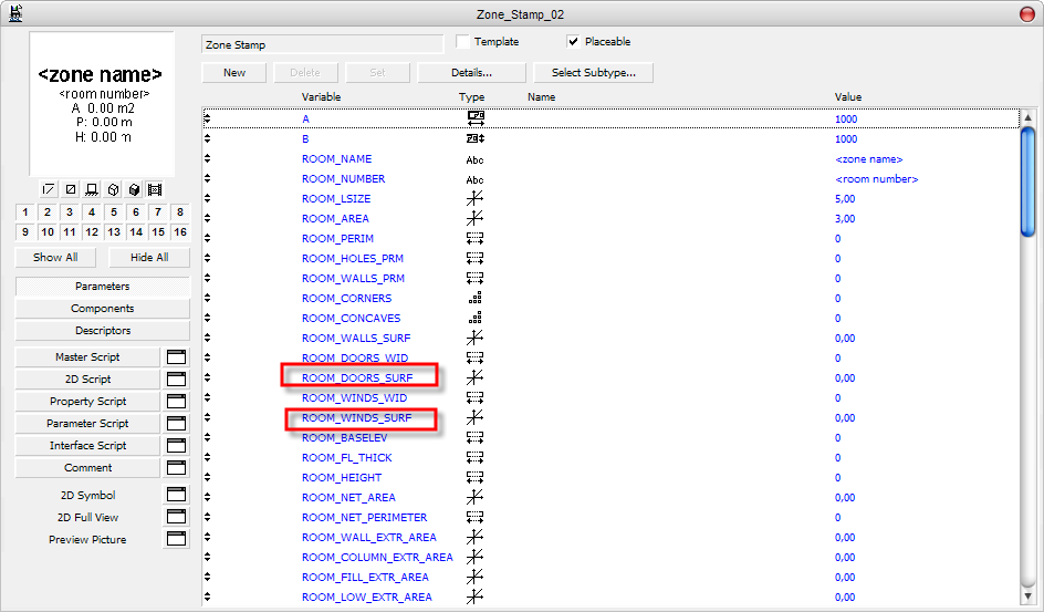

http://www.graphisoft.com/support/archicad/archiguide/zonefixparameters.html
It should be possible (I have not tried).
If you open a Zone Stamp object for editing, you will see ROOM_DOORS_SURF and ROOM_WINDS_SURF are the two global Zone parameters you are looking for.
Simply convert their values into string format with the STR command and write it out with the TEXT2 command in the 2D Script of your Zone Stamp.
It should work.

OK, I did it. I was interested in this, so I modified one of the ArchiCAD 9 Zone Stamps.
It is in the attachment.
I show you an image of the result.
The Total Window and Total Door area can be displayed just like the Area of the Zone.
The Text Style, Font Name, etc. can be set just as well.
In the Master Script and 2D Script of the Zone Stamp I commented those lines which I inserted.
