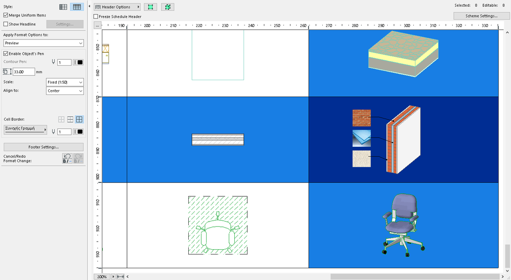

Hi again,
fittings are objects you can find in partcommunity, cadenas or traceparts. these sites export models in skp format
finish is building material or surface. It seems that you can only get a vectorial hatching preview. But I just tried and you can drag and drop images in the annotation of a scheduled preview.
Also the in 3D preview anotation you can dimension like in 3d document. The only difference from 3d document is that you cannot have hidden line view option, which is important for mechanical drawing standards (parts, fittings, etc). I really wish that this will be incorporated in the future .
Regards
Here is an example.

alemanda wrote:
But If I'm not wrong not all the element have a preview ...
The 2D, 3D preview options are found in the GENERAL section I think you can choose it for almost everything. I triyed in Elements, Components and Surfaces
Regards
