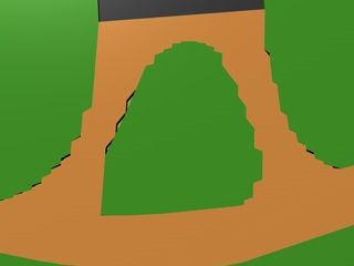

I just imported a number of slabs with rounded edges to C4D using the exchange plugin and what I got in place of the curved edges was a series of ragged steps. This occurs with both slabs and meshes. Does anyone know of any way to eliminate these? I can import straight lines fine, but any time I try any thing with a curve, the end result is the same. Help!
[/img]

Export from AC using the Wavefront format it behaves better than the plugin.

Boy are you right on! .obj's worked without a hitch. Thanks.
