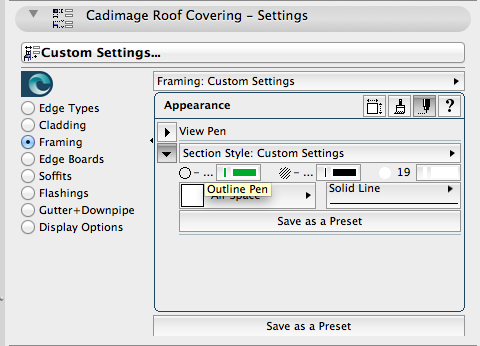

cadimage roof not showing correctly
I have created a roof and then used a cadimage roof covering to cover that. On one of my cross sections the roof doesnt seem to be displaying properly. I decided to delete that roof - but when i deleted it - it seems that there is another cadimage roof underneath (which shows correctly) but when i delete the roof that displays wrongly - it deletes the roof completely in the 3D view. Anyone know how i can get around this?
11 Replies 11
There are two areas for setting pens; View Pen (plan) and Section Style. Have you set them correctly in Section Style? Also, is the roof covering on the right renovation status (not being overridden?)
YAY that worked. thanks heaps! I didnt even realise that section settings tab was there
