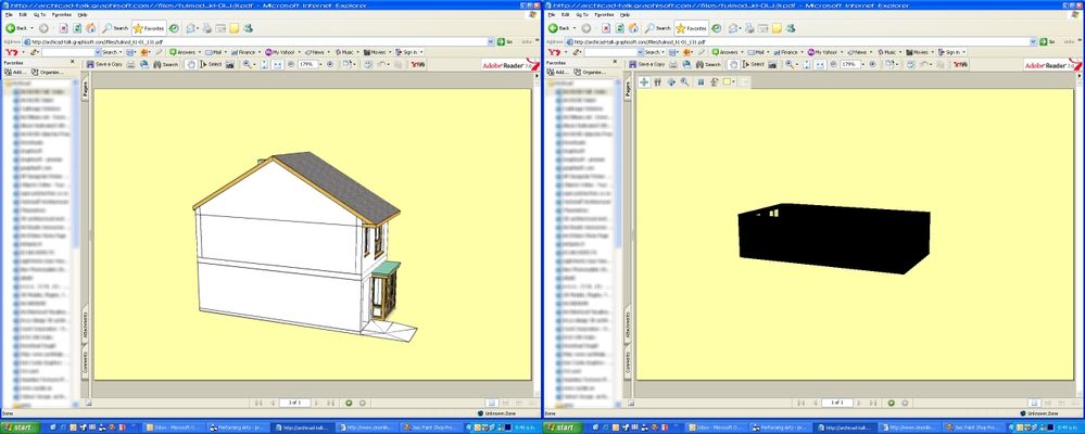

When I view your PDF it initially shows up o.k. (left image) but when I click on it to rotate (cursor is a pointing finger) it changes to image on right. It does rotate / navigate but with no light at all.

s2art .. check you have the latest update for Acrobat perhaps? I've tried this file on 2 machines here with the current build (7.0.8 ) and its fine, but on a machine with 7.0.5(or .4? ) i had the same problem you show.
Updating as i speak so will let you know if this fixes the problem.
That's right, I have 7.0.8 as well and it works fine.
