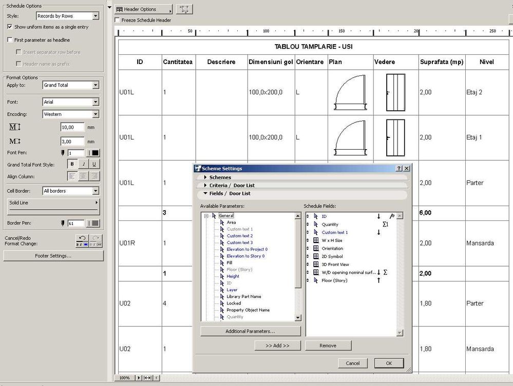

Hello,
now i have some questions about door schedule (and the same for the windows)
1.in romanian standards for d/w schedule we need to put two dimension types, one for the hole and one for the carpentry. the dimension of the carpentry is usual smaller with 5 mm. How do i put this on schedule?
2.i need to put some description in the schedule for every id, but i need the text to be multilane not a single line. I've try custom text 1 but is single lined
and i don't get the idea. if the height of the cell will permit to put multilane text why not? Maybe you have another solution to put some text in the schedule or in door tags.
That's all important problem's i have right now.
Thank you
ps.sorry about the romanian headers in the schedules

Thank you for your reply
meanwhile i've found something very very interesting
it's almost exactly what i've been lookin for
in the door general settings when the nominal opening is on, are 4 parameters (unit W/H and wallhole W/H) BUT in the schedule i can't find the wallhole parameter, i've found only the unit w/h.
see the image attached.
If I've found those parameters in the schedule will be perfect....almost
the problem with multi line text is still unsolved.
maybe one of you found those parameters in additional parameters or somewhere else.
Thank you again for your support.
Karl Ottenstein
Matthew wrote:
I don't know the IS well enough to know if it does multi-line text.
Unfortunately, there is no text-wrapping in the IS - a wish from the moment it was introduced. I have not tried the tricks of "\n" etc to force a new line with the IS in AC 10 to see if even that is working yet.
Karl
AC 28 USA and earlier   •   macOS Sequoia 15.3.1, MacBook Pro M2 Max 12CPU/30GPU cores, 32GB
Link
Graphisoft Partner
Graphisoft Partner
Unfortunately, it doesn't.
Cheers,
Link.
