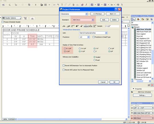

measurement displays in schedule
The attached screen shot shows my problem, 0'-1 1/2" in the THK column. I want it to read 1 1/2". The screen shot also shows my dim preferences and the active dim style in quick options. My Calculation units are set to decimal inches. What else do I need to do to get rid of the 0'-? In the parameters box of the door it reads as it should 1 1/2"

I have asked this before and the answer seems to be that you are stuck with the 0' regardless of your settings. However, if someone has a solution I would love to see it. (perhaps this is fixed in 12, but I haven't tried it yet).
