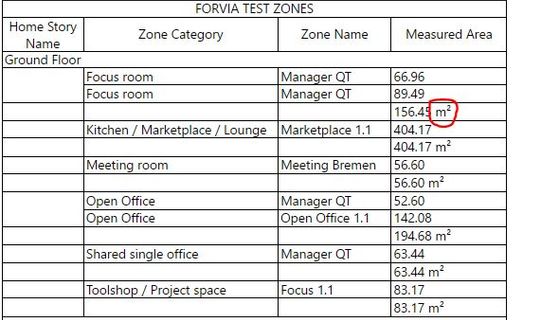

I'm trying to create a schedules list for my zones, and then export the info in a excel table in order to create a pie chart for the zones.
I need ArchiCAD to not show "m2" for the Total of the Measured Area in this table. (see pictures below)
Operating system used: Windows 10 Enterprise
Setup info provided by author
2 Replies 2
vlahtinen
I think the only way is to create a new property for zones. The property should convert the Measured Area value to a number (instead of an area) and probably do some rounding as well. You can convert the area to a number with the formula "{Property:Zone/Measured Area} / 1 m2" (without quotation marks). Then you should schedule this new property. Note that if the value is rounded within the property, the sum of the property values will be based on the rounded values instead of the exact values.
Does it help if you have a schedule without the totals?
I am pretty sure you can calculate the totals in Excel if you need them.
Duplicate the schedule if you still need the totals in Archicad for use on a layout.
