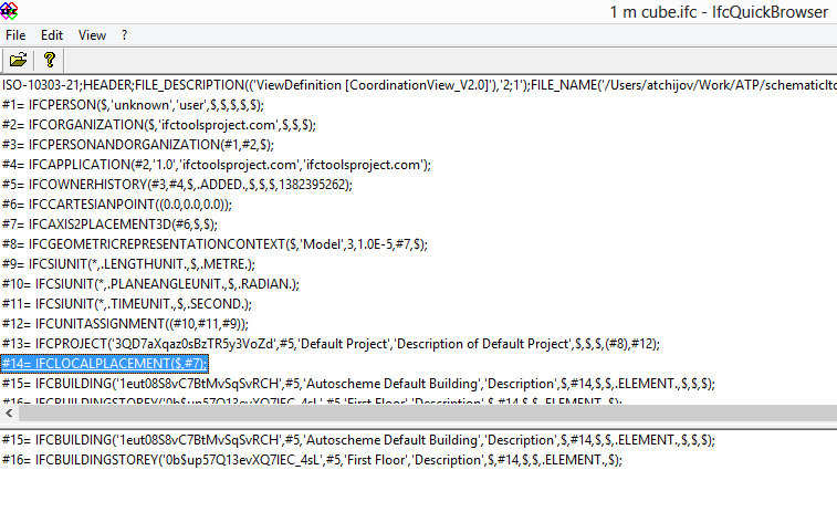

IFC4 permits a placement to be referenced by multiple products, IFC2x3 mandates only a single product can reference a placement.
IfcQuickBrowser is another useful utility for checking relationships. Refer image. Building and Building storey are both referencing the placement in question.
If the file is working, it's not the end of the world but certainly minimizing errors is a good way to ensure success in opening the ifc in Archicad.
