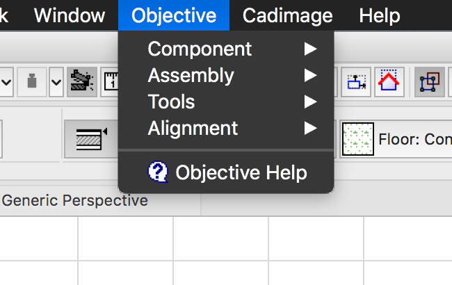

This is the menu in archicad 19 (Objective -> tools -> rotate)- i wonder where it is in 20. In Archicad 20 i don't have the objective menu
Objective is an add-on from CADimage.
http://www.cadimage.com/Tools/Objective
If you already have it for 19 I don't know if this allows you to upgrade for the 20 version or if you need to purchase it again separately.
I don't use it so not sure how the licensing works.
It'll be under the Cadimage menu if you have it (and are using the Cadimage based Work Environment)
