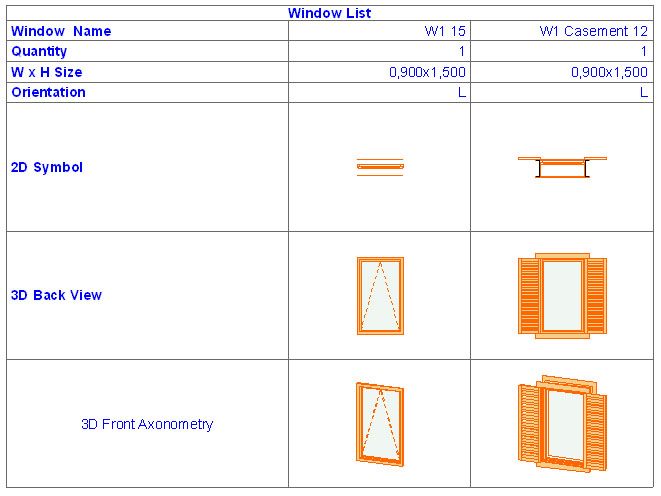

Is it possible to show doors casing in schedules ? "in graphic representation of elevation and / or plan " ?

A while since I did that, but as I recall it will show if it's part of the window object. Which it is if you're using Archicad's standard windows.
That what I thought too specially that it shows as part of the door in the settings preview box.
but not in the schedule . anyone ideas ?

Not really. it affects the door leaf and the frame . but in all scales, no casing " both in front view and plan view"
If they are part of the door object and they show in plan and 3D but not in the schedules (at the same scale as the plan) then they must have been scripted not to show.
Have a look in the object for a parameter to turn them off in schedules - this is a long shot but you never know.
Or look in the 2D & 3D scripts for something like ... IF GLOB_CONTEXT <> 6 THEN ... code for moddelling casing ... ENDIF
If it is there try commenting out the red bits so it models the casing in the schedules too.
This is all a bit of a guess without knowing exactly what library part you are using.

If you use library 12 everything works fine, casing and sunshades will show in schedules, but if you use lib 13, 14 and 15 this just wont work?
