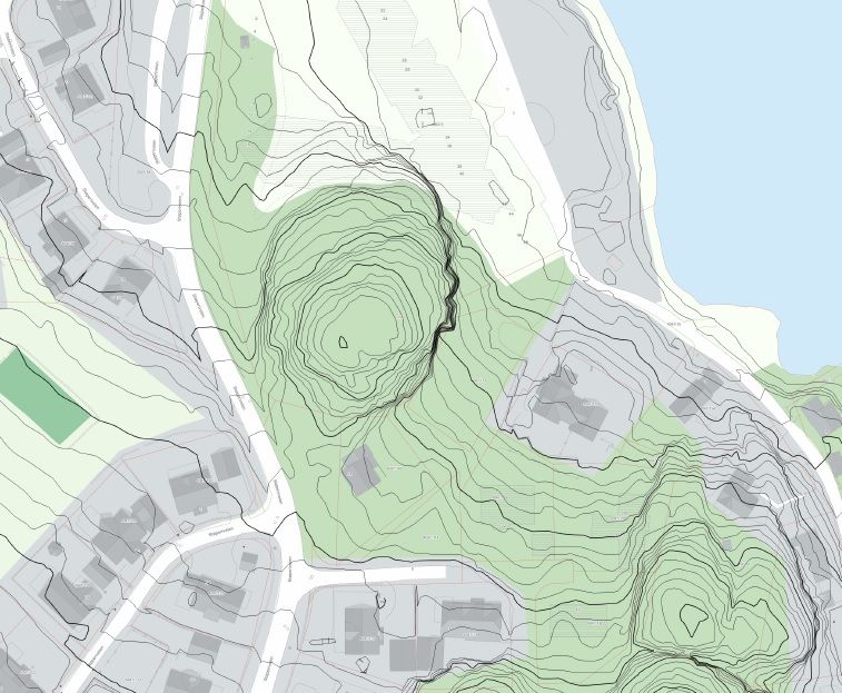

Petter,
Place the PDF on an new Independent Worksheet, highlight the pdf, right-click and select "Explode into Current View". you have the option of deleting or keeping the pdf. if there are vectors, this command will create a grouped collection of vectors. ungroup or suspend groups and away you go.
