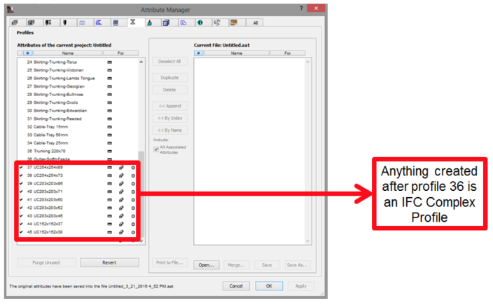

  • Make sure that the complex profiles list is fully populated in terms of their numbers. In the screenshot above, profile #2 was missing. After IFC import, a new IFC profile was placed into the #2 slot. In a large project, it may be difficult to find and remove this profile later, in case of the revised IFC Import. To fill in the gaps and avoid this, I recommend creating a 'dummy' complex profile attribute file in which all dummy profiles are numbered correctly. You can then load this dummy attribute file into the main project via Attribute Manager (Options > Element Attributes > Attribute Manager) and use the <<By Index button to load these profiles to populate the gaps. When you next import the IFC, all newly imported profiles will be placed together, at the end of the list of complex profiles.
Example: 36 profiles loaded into a project. When the IFC is imported, I can now easily see that anything after profile 36 is an IFC profile
