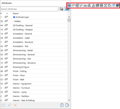

  • when in list view:
    • display all of them or
    • filter and list them by type. Click the attribute’s icon to list or search only that type. Long-press the list view icon to make the icons of all attribute types appear in a row

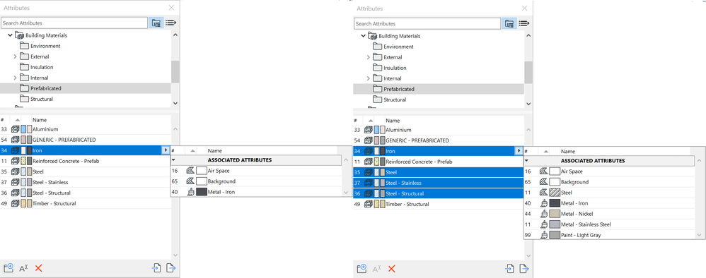

The Attributes Palette displays the attributes in their hierarchical context:
  • When an attribute that references other attributes (Surfaces, Building Materials, Composites, Profiles) is selected, the associated attributes are shown on the side. When multiple attributes are selected – all associated attributes are listed:
  • double-click any attribute to open and edit in its settings dialog (editor). There is no need to close the Attributes Palette and return to Options > Element Attributes to open the setting dialog of the selected attribute.
