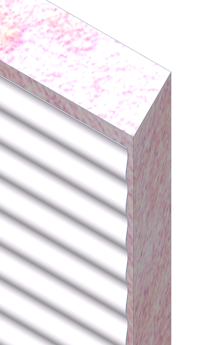

This is a post with a few questions but all relating back to the best way of creating a wall containing sinusoidal cladding.
We have previously been using a complex profile wall, where the outer 'skin' is a fill in the shape of a sinusoidal wave. This works great for rendering but..
i) The cladding is what it is in elevation. Every point that forms the 'wave' in complex profile/section translates to a 'line' in elevation. Which makes the elevations way too...liney, and unpleasant to look at.
So, I came up with a workaround which involved removing the physical representation of the wave in our complex profile and replacing it with material/surface that uses a jpeg manually shaded to look like a wave. Then we use vectorial hatch/cover fill that is just a horizontal line that we can alter independently for use in elevation.
Then for a correct representation in section I created a fill which looks like the wave. The trouble with this approach is;
ii) In plan, the wave fill pattern appears the same, so it appears that in plan we have a sinusoidal wave applied vertically, and in section the wave appears horizontally. Can we overcome this issue?
iii) If I create a curved wall using my complex profile, my new 'wave' material becomes unaligned??

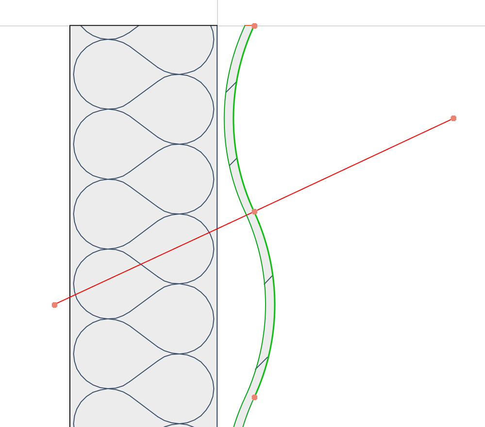

Daniel:
I think you can achieve what you want using your first method (Complex Profile with curved fill for cladding). Just make sure there are no straight segments in the fill, and the curves are tangent where they meet.
David
David Maudlin / Architect
www.davidmaudlin.com
Digital Architecture
Hmooslechner
I really tried to do it but i cant get the profiles without the lines between. Ill try some ideas but there seems to be some limitation...
David Maudlin
Rockstar
Hmooslechner:
1. Draw an Arc for one part of the double curve (sine wave). Rotate this Arc so the radius of its midpoint is horizontal.
2. Rotate a copy of this Arc around the endpoint of the original Arc. These two Arcs will be tangent to each other (a Line draw from one Arc center-point to the other Arc's center-point will pass through the endpoint connection of both Arcs, as per my earlier illustration).
3. Drag a copy of the two Arcs horizontally the thickness of the cladding.
4. Select these 4 Arcs and Multiply them the height of the Wall.
5. Draw lines at the top and the bottom of the Arc shapes to connect them (so the two undulating Arc shapes have a boundary.
6. Magic Wand the Fill for the cladding inside this bounded shape.
7. Save Profile.
David
