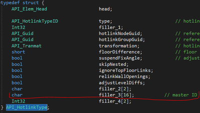

When I look into the header file, I can see that filler_3 is supposed to be the MasterID, but when I print it out I just get an empty string.
Can anyone tell me how to edit the HotlinkMasterID with the API?
