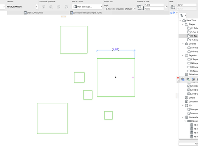

Hello!
I'd like to create a rectangle whose size would be random each time it is placed or a parameter is changed.
I've based the rectangle on a graphisoft object I found here:
It's a rectangle of height A and width B, where A = B.
The object is coded so that point 0,0 is in the middle.
A dynamic hotspot to manage the A value is located at coordinates 0,A/2.
With the RND() command, I manage to create squares of random size, but I have two problems:
  • The dynamic hotspot is no longer located on the rectangle, even though it should be there by definition.
  • The A value displayed by archicad does not correspond to the drawn A value.
Could you help me? Thanks in advance

MetalFingerz
Hello @Mathias Jonathan ,
For your Master script
!MASTER SCRIPT
aleatoire_scale = RND(0.4)
temp_scale = A*(0.8+aleatoire_scale)
A=temp_scale
B=temp_scale
halfA = A/2
And for your Parameter script
! PARAMETERS SCRIPT
PARAMETERS A = A
PARAMETERS B = B
PARAMETERS halfA = halfA
lock "B"
You need to define halfA in the Master script because it is ran beforehand. When done, halfA and A are set at the same time and you do not have any discrepancy between both parameters.
