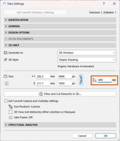

On the layout window select the placed 3D view > Right-click > Modify Source View Settings.
In the View Settings of the 3D view, you'll find the Resolution parameter under the 3D Only section. This value determines the sharpness with which the 3D view appears on the layout. Higher values will result in a more precise display.
Recommended settings:
  • For editing, a low resolution is usually sufficient (e.g., 72 dpi).
  • For presentations or high-quality printing, a higher resolution is recommended (e.g., 300 dpi).

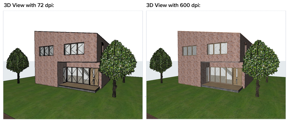

Comparison of image quality with different dpi values:
