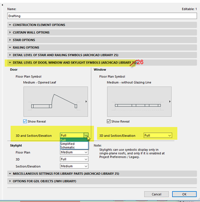

Check your Model View Option for the Level Of Detail for doors and windows.

Solution
jasminers
OMG!! Thank you so much ^^
