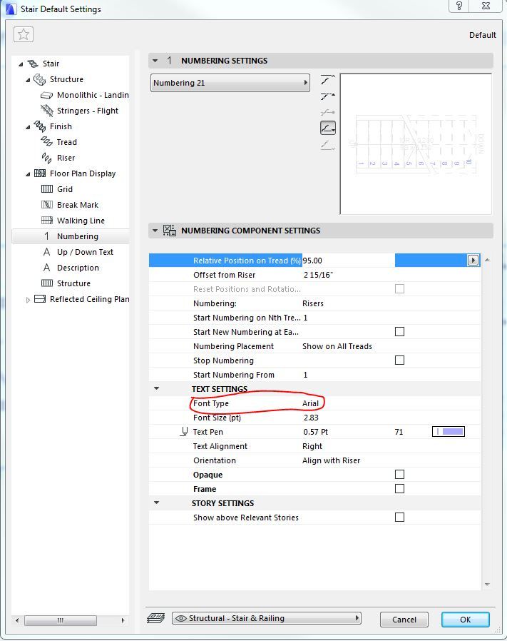

Is there a way to change the font for the stair in AC21? Specifically for the numbers, dimension text and "Up" and "Down" text.

Thanks Barry. I can find those but don't see any options for changing the font only to turn text on or off. Am I missing something?
Here is the setting to change the font, the same is true for the others texts of the stair.
Is this what you are looking for?
Thanks for the visual! I completely missed the pull downs on the left.Those open up a whole new world. Sorry for the dumb question.
