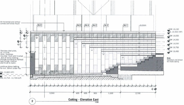

here a scan of the same file printed from adobe reader 9.4.6 to the xerox apeosport 4400 - notice that the hatch lines are interrupted and not continuous, in fact they print as a dashed line type.

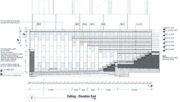

schagemann
here a scan of the same file printed from adobe reader 10.1.1 to the xerox apeosport 4400 - again the hatch lines are interrupted and not continuous as above...
