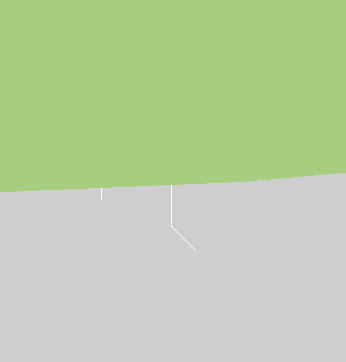

Here are two polylines that both adjust to the shorter part, when adjusted to the green/gray border (the meeting of two fills).
EDIT: I took a printscreen of the "after" as well
/Kaj

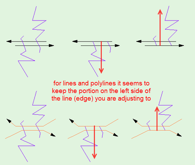

Thanks for that.
If you are adjusting to a line or open poyline, it seems that it keeps the portion of the polyline that is on the left side of that line you adjusting to.
So you need to know which direction the line was drawn.
If you are adjusting to a closed polyline (and I assume that applies for fills, slabs, meshes, etc.), it seems to keep the portion that is inside the closed polygon.
Is that what you are finding?
If you are trimming to a straight edge, I think I would use the 'split' command and keep the bit you want to delete selected so you can simply delete it.
Split doesn't work for polylines adjusting to a curve - only lines adjusting to a curve.
And if you split to a straight edge it will split everything selected to that one edge - can't split to a multi-faceted edge.
