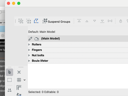

I docked the Design options palette and now I can't undock it!!! (other palettes work fine) its this a bug or am I missing something.

Reset your workspace from the work environment and check whether this can be reproduced.

applied a different style and the palette goes away as expected but adding it to the top of the windows gives the same result. If I add it to the side of the window it acts normally. ( that's where I want it anyway)
John H
I can also confirm that after a "New and reset" a clean file has the same problem - seems to be a bug (Mac silicon build 3001 AUS)
Top docking - problem
Side docking - all good

I can confirm the same error on a PC running Windows 11.
If you by mistake have the Desig Option dropped and henced docked (at the top) it is not undockable. Unless you reset your work environment.
