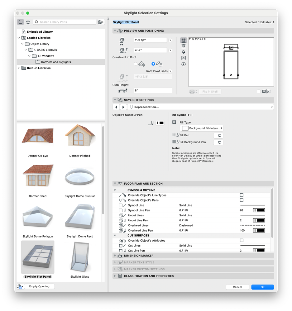

It's the "Skylight Flat Panel" and is in the Basic Library. I have attached a screenshot. This situation occurs with all the skylights in this library pack.

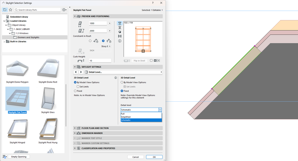

Maybe the 3D Detail Level setting in not set to "By Mode View Options".
Using the following settings I could get the same result as you. In this case, Model View Options settings are disregarded.

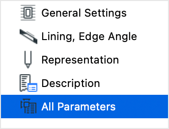

Thank you. I'm afraid that I do not have a "Detail Level..." setting option in my library.  Also, I just checked, and I have the most up-to-date libraries. I also tried unloading and reloading the Skylight Libpack to see if that would help. It didn't.
I see. I guess you are using the Ac28 version while I was checking the Ac29 Tech Preview version first.
