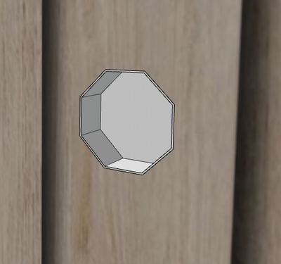

Are there any examples of GDL script that can be added to a custom object that will remove the volume of the object from a wall the object is placed in? And if so - would that be more/less/same overhead from just doing a solid element operation?

Apart from the opening tool:
1.Draw a slab of a shape You need.
2.Assign "wallhole" ID to it
3.Save as a window
As a GDL object, it has to be a door, window or opening sub-type.
If there are only a few, I don’t think there would be much difference in overhead.
But if there are many, I think SEO will be more overhead.
