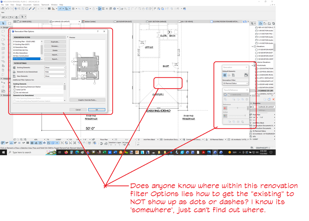

Adjusting the Renovation Filter settings so "dots" don't show as existing.
Does anyone know where within this renovation filter Options lies how to get the "existing" to NOT show up as dots or dashes? I know its 'somewhere', just can't find out where.

It seems you don't have "Show" selected for "existing" but it looks like you have "override" selected.
If you want to show up solid line  you should to either select "show" in Filter Settins or change (deactivate) the Line Type in "Graphic override rules" for Existing elements if you selected "override" in Filter Settings:
or maybe you have an active Graphic override combination with a dotted line for existing elements.
