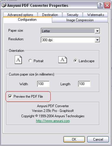

In the past when creating PDF files in PlotMaker using the Amyuni PDF Converter, after creating the Reader would open and the PDF could be viewed. I actually have not decided if I like this of not, but it no longer opens the Reader.
In the Amyuni PDF Converter Properties (See Attached) I have the "Preview the PDf File" checked. Is this the place for this setting?
With "Preview the PDf File" checked, I don NOT get a Preview or even a "Post view".
You should also point it to the Reader; usually happens after you click OK in the dialog you posted.

Finally went back and "pointed" the Driver to the Reader. After an Update from the Acrobat 6.0 to the 7.0, the exe file was moved. It just took un-checking and then re-checking the Preview box an then I was asked to locate the File. (Which was now in the Acrobat 7/Reader folder.
Thanks as always Djordje.
