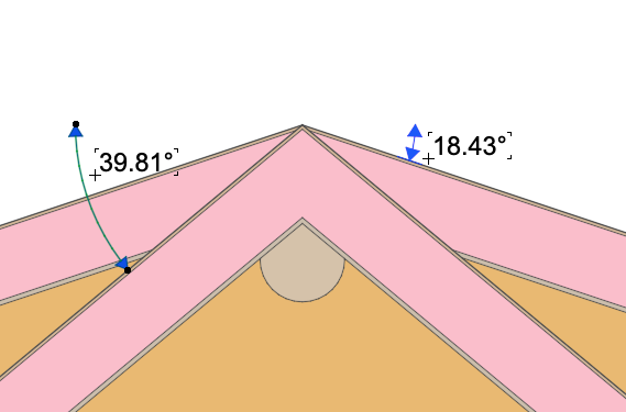

how do i get angle dimension to show a horizontal witness line for the angle call out for 18.43 & 39.81?

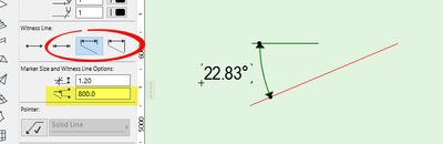

What settings do you have for your witness lines?

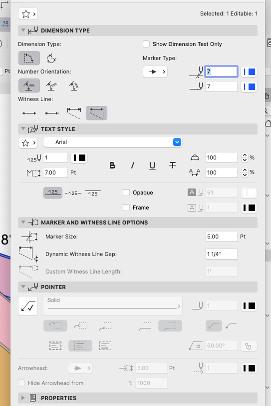

i thought all options were attempted on my end and went back to create your screen capture. however, still nothing?

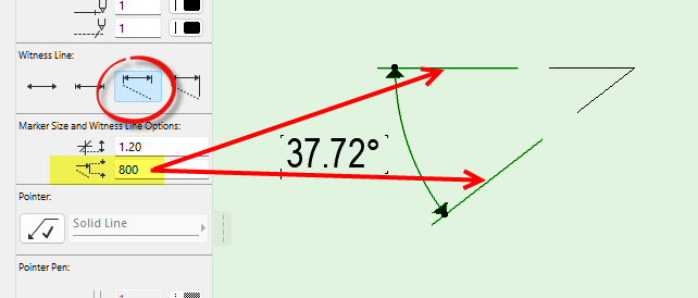

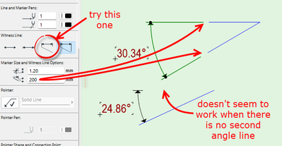

The 'dynamic height' option for the witness line does not seem to work when there is no second line to measure the angle.
You are just picking a point along a guide line and it does not seem to like that.
Change to the 'custom heght' option.
