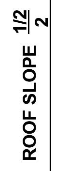

Is there a way to annotate a roof pitch in plan conforming to the US system?

‎2023-04-27 04:45 PM
something like this ?
