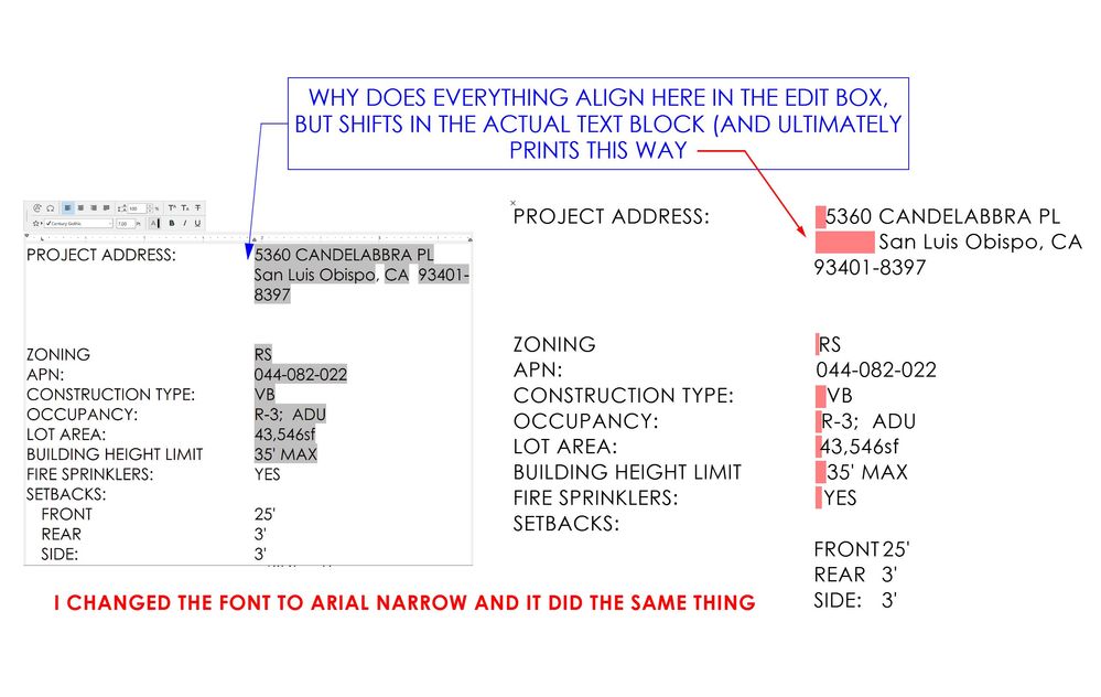

It's the little things that drive me nuts... Why does everything look fine while I'm editing, but then shifts when I'm done (and when I print)

Does publishing to PDF result in the same tabbing changes?
| Win11 | i9 10850K | 64GB | RX6600 | Win11 | 7800X3D | 32GB | RTX5070TI |
2023-04-27 09:48 PM
Yes...

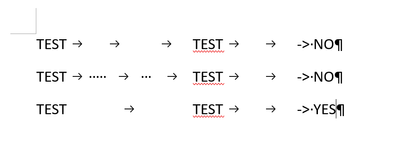

Hi Duane,
did it start happening in a migrated file from AC25 to AC26?
I have an abbreviation list that worked fine, and it's all messed up in AC26.
I also have a tabulator set and my text is 75% in width.
If I go back line by line and make sure there are no spaces and only one tab (to the set tabulator), it works again.
