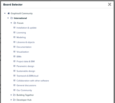

Also, if the userbase is to conduct quality control for Graphisoft/N, then it would make sense to introduce a board to this forum called 'Bugs found by stressed users in the lead up to Christmas'. Or at least a Label which can be called 'Urgent Bugs'.
Both seem to be missing, and presumably Labels are locked down so GS can save face. i know 9/10 of my posts labels would include 'bug'
