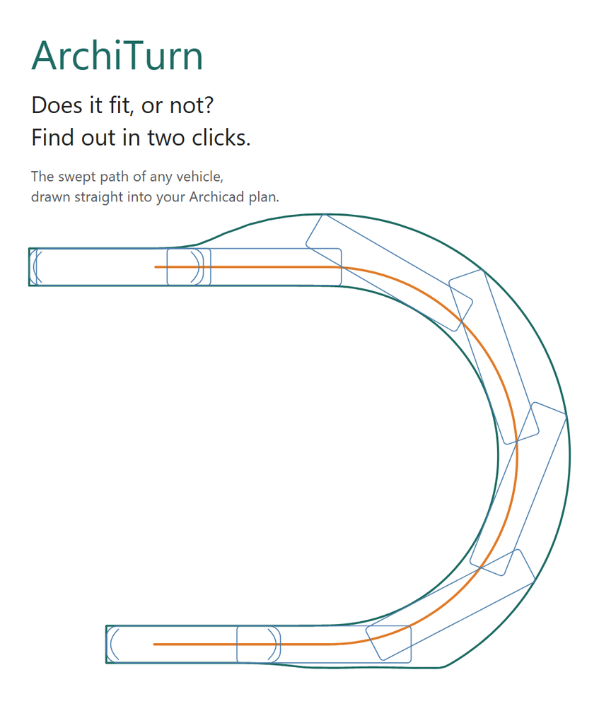

I'm an architect from Romania and I've been building a small add-on for a problem I kept running into: checking vehicle swept paths — fire-engine access, roundabouts, parking manoeuvres, garage ramps — without leaving Archicad.
WHAT IT DOES
- Swept Path (from Selected Polyline) — draw the intended path as a polyline, select it, pick a vehicle. You get the swept envelope, the driven path and the vehicle at start/end, plus a report: FEASIBLE / NOT FEASIBLE, minimum radius vs required, area, margins. If a corner physically doesn't fit, it refuses and tells you which vertex and how many metres are missing — it never draws a lie.
- Drive with Mouse — drive the vehicle through the plan with the mouse; what you see while driving is exactly the final drawing.
- Vehicles: car, van, rigid truck, city bus, and a semi-trailer truck with a live articulated trailer (jackknife detection included).
- Everything lands as ordinary Archicad elements, grouped — one Undo removes it.
