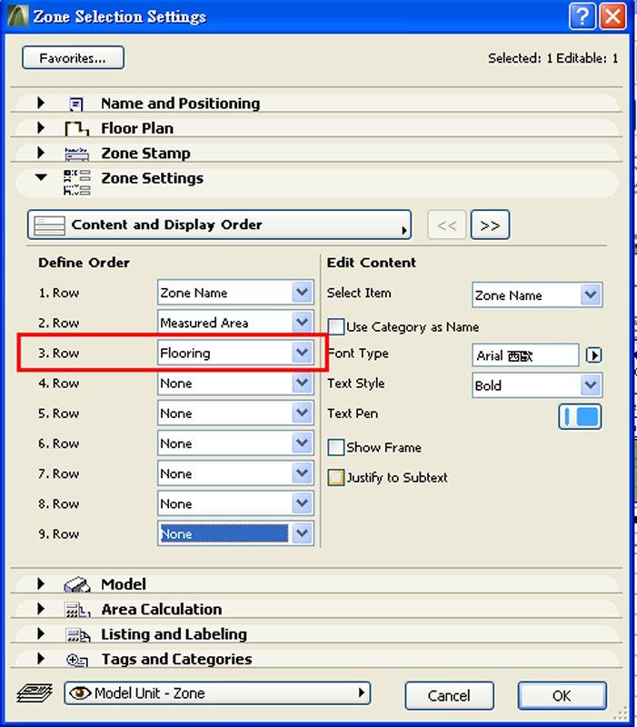

In archicad 16, the zone setting have the "Flooring". I could use this text to show my customized words for displaying wall finish, ceiling finish, etc. (Fig. 01)
However as I try to use the schedule to summarize the zone element. There are no fields of Zone list to show "Flooring". (Fig. 02)
As I want to show the customized words of Zone in plan view. Meanwhile this customized words could also displayed in Zone schedule. Are there any solution ?
As I want to show the customized words of Zone in plan view. This customized words could also displayed in Zone schedule. Are there any solution ?
Looks like you have a custom Zone tool. By the way - Neither "Floor" nor "Flooring" is an AC tool, nor are any attributes named that way. So I imagine you should reference either a cover fill or a material (both of which I see in your list on Fig 02).
