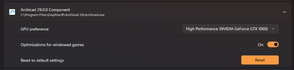

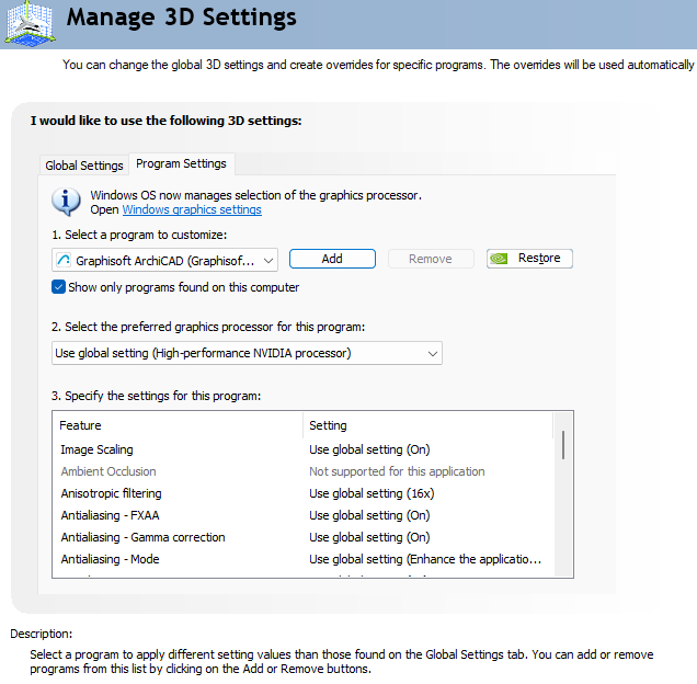

Yes my Archicad app is set to use my dedicated Graphics card in both directly in the driver settings & the newer Windows settings.

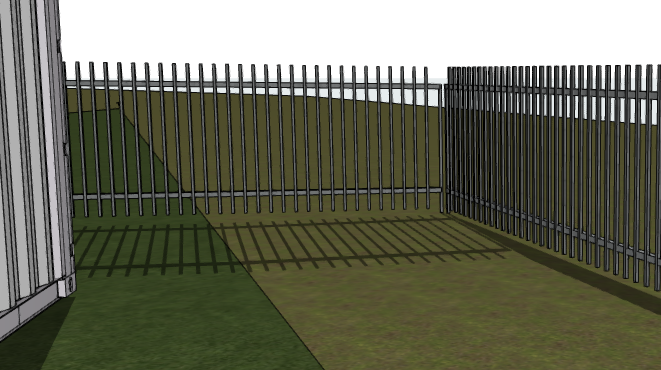

This plan view that I'm trying to dimension on is a simple Site Plan (with only the 3D mesh, Zones, a fence railing, some lines text & 2 fills).
I read further & found a clue in this reply (not searchable, the clue is in the GIF image) that a railing was identified as the cause. I tested it on my file and there we have it... hiding the layer my fence railing is on, immediately stopped the lagging of the dimension tool in my project file.
This is half of a solution at least, but brings up the next questions. We have threads about lagging dimensions going back 4+ years, some with workarounds.
PS: We need to dimension fences (railings), so after seeing the result from hiding the railing's Layer, I got an idea to split this simple palisade railing and test if the dimensions are fine with the Layer visible. This fence railing was +/-75m long with 6 segments. I split the one single rail into 3 and indeed, dimensions are snappy with no lagging again.
Now that this issue is narrowed down, we at least know the cause in this case and hot to avoid it.
We still might have cases where splitting railings is not ideal for modeling (especially linked railings) & more difficult than necessary to manage (ie. settings, display options, properties, expressions, etc). I hope therefor this dimension issue could be solved sometime.

Go into your Windows Display settings then Graphics settings.
Set your Archicad program to use 'High Performance' settings.

You could also ensure your video drivers are up to date for both the built in and dedicated video cards.
