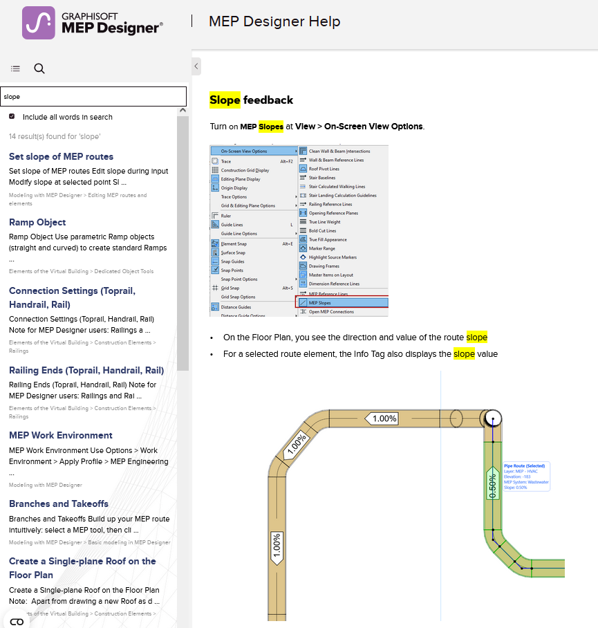

Hello, how can I label the slope direction (arrow) of MEP routes? There is an on-screen view option showing the slope and slope direction, but nothing that could be shown on printed documents.

You could, back in 26. But can't anymore since 27. I've came across the same situation a couple days ago. It's very frustrating.

I can't say for other versions, but you can in 29.
Hi Barry, if I am not mistaken, this what you are showing is only a On-Screen slope display setting. It cannot be shown in print (layout).
That would be correct.
I should have read the bit that says "On-screen View Option". 😮
I know you can label the slope, but I an not sure how to show the direction then.
