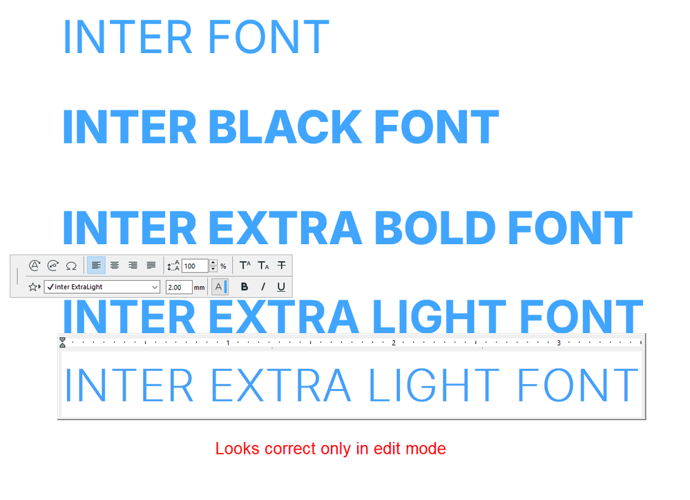

As I said in the title, some of the fonts dont display corectly in the newest version (v29). Had the same problem when updating to v27, had the same problem when updating to v28, and ofc, I have the same problem now.  But hey I can talk to my program now.
Anyone else haveing this issue? again

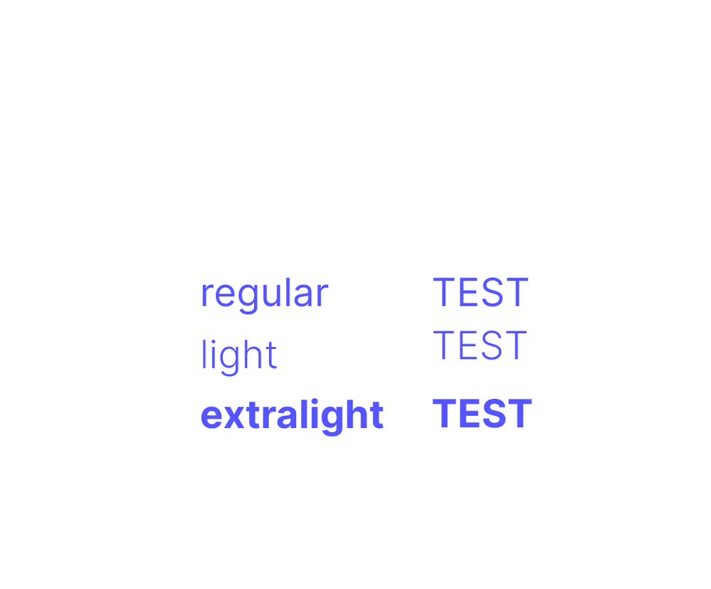

I just downloaded to test and can confirm it does work fine in 28 but not 29.
When you edit the text it looks OK, but as soon as you exit the editor, it is too thick.
You will need to report this to your local support.
Or you could try the support site and submit a ticket for 29 Technology Preview (even though that has technically ended now).
https://support.graphisoft.com/hc/en-us
I have reported it as well, but it would be a good idea if you do too.

Did you solve the problem in the other versions?
Or is it just the particular font you are trying to use?
What fonts have the problem?
Can you show an example of the problem?

The other versions started working eventualy when graphisoft updated them, but that was always a couple of months later.
The font thats giving me problems this time is googles Inter font.  Specificaly the extralight variant, which appears very thick. (see attached image)
The font is an integral part of my office template, hence the frustration.

Solution
