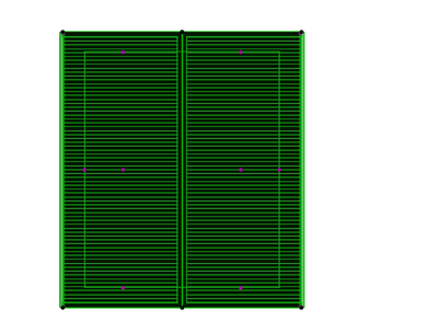

Hi there, I'm an Archicad student currently using Ci Tools Roof Coverings for an assignment. I'm having trouble removing the solid black fill that is displaying on my roof covering in plan view. I've tried changing the pens and fill settings, but the appearance doesn't seem to update. Could you please advise where this black fill is controlled and how I can make the roof covering display with a lighter or transparent fill instead?
Thank you for your help.

I'd:
- Check the object fills and pens (make sure none is set to black)
- Check if you have any graphic overrides active (that might override the display settings for this)
- Check the MVO (Model view options) also for any display settings.

Given that the addon generates a 3D object, make sure that it is set to show Symbolic in the floor plan, else every ridge and valley edge will draw a contour if enabled.
