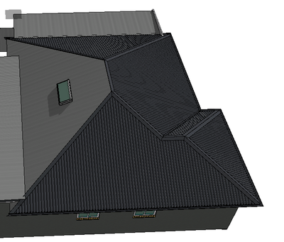

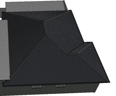

Can anyone help me out with this annoying issue with the design extra > roof accessories> roof builder
the roof builder disapears in 3D view if a skylight is input once the skylight is deleted the roof builder in 3d view returns, however the roof builder stays visible in floor plan at all times... very frustrating. any solutions? Thanks Ahead
Operating system used: Windows Windows 10 pro
2 Replies 2
Try a little experiment.
Skylights automatically create a hole in the roof.
So out of interest, create a hole in one of the other roof planes and see if the accessory shows or not.
If it doesn't then I suspect the roof accessory add-on or roof builder GDL object is not capable of showing holes in a roof.
They are both quite old I believe.
If it does work, I am not sure what the difference is between a normal roof hole and a skylight hole.
I can see to options.
If adding your own hole works, do that.
If not, add the skylight as an object (not with the skylight tool).
It won't be associated to the roof, so you will have to adjust it manually.
