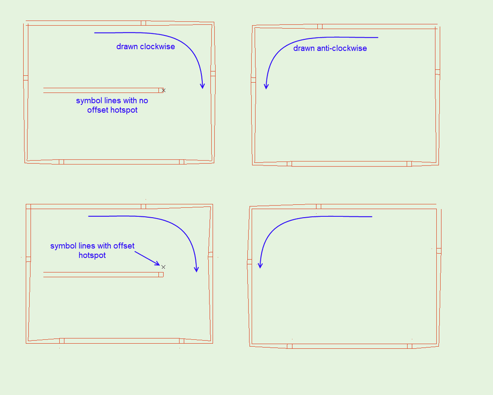

Can you show the Lines Dialog with the definition of the Line type you are using?
I see, you have created a symbol line.
If you just copy and paste the pattern it will be centered on the reference line as you draw the polyline.
I don't know why, but with a polyline, the corners will be distorted towards the reference line.
If you add a hotspot to your symbol lines and offset that by the width of your lines, you will force the symbol lines to adjust the centre so now one of the lines will be on the reference line of the polyline and will not be distorted.
The other side still gets distorted.
The hotspot side is also being distorted, but there is nothing there to see.
Drawing the same with lines (or explode the polylines) is a little better, but the corners will not trim.
The direction your draw the lines / polylines, also has an effect.
I think just lines will be your best choice.
I don't think you will win with polylines and a custom symbol linetype.
