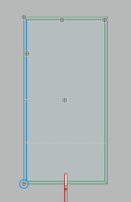

I'm relatively new to AC and maybe I'm missing something:
With the dimensioning tool, I can't seem to figure out how to use associative dimensions with objects (e.g. the built in mirror object from AC). I can only use the non-associative ones... If I move/resize the mirror then the dimensions aren't correct anymore.
AC 29 UK macOS Sequoia 15.6.1
What do you mean with movable node? So this is a mirror object from the Archicad built in library and I've tried all possible surfaces/edges/nodes (the points that appear when I drag/move the object) - they are all square non associative cross hairs. The faucet below which is a .rfa import also has the same issue. The dimension tool's "Static Dimension" setting is unticked.

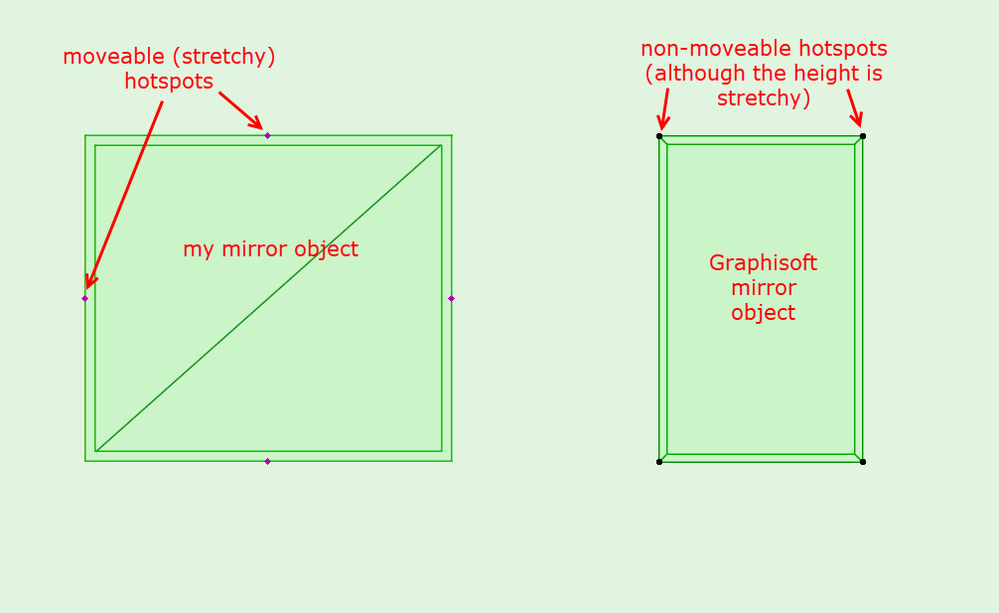

When you select the object, you will see black round hotspots or pink (coloured) diamond hotspots.
The black ones are just regular hotspots and dimensions do not associate to them.
The pink diamond hotspots are moveable and the dimension will associate to them with the circular cross hair.
Whether an object has moveable hotspots or not depends on how it was scripted.
What confuses it a bit is that in some objects, the black hotspot can be stretched for the height, but these will still not associate to a dimension.
Other elements like walls, beams roof, etc (not objects) will be stretchy with black hotspots and the dimensions will associate to these - confusing I know.
It is only when choosing the dimension points, can you tell if they are associated or not.
Square cross hair = not associated.
Round cross hair  =  associated.
If an object is not scripted with moveable hotspots, there is not a lot that you can do.
Other than script your own objects, which is what I do.
