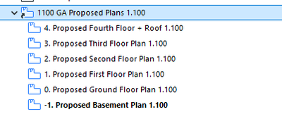

I currently rename the views in my view map with Existing/Proposed status and scale (1.100, 1.50 etc.) like this:
This helps me keep track of views when putting them on layouts and avoids having identical names for views.
Archicad knows that the views are that scale and their rennovation status. Is there an automatic way to label views like this? It would save me so much time if I could just put <level> <rennovation status> <story name> <scale> but from what I can tell this currently isn't possible?

I wish view folders allowed for something like layout subsets layout name settings, with prefixes and suffixes and stuff.
