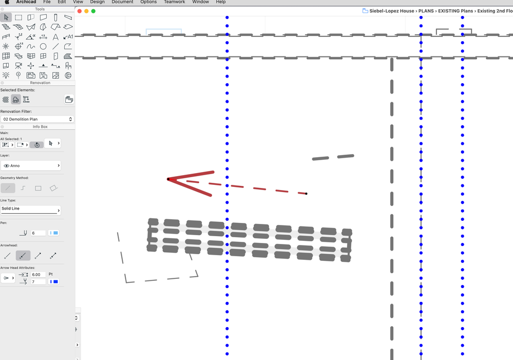

My line type is stuck on one dash type, for any tool. This just started--I've been working on this file for over a month. It started when I clicked on a favorite. It's only for this file--other files are ok. Quit AC, restarted, same.

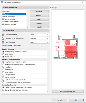

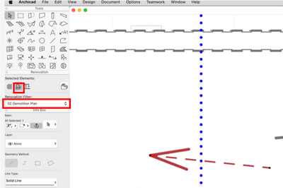

You are in a demolition renovation filter.

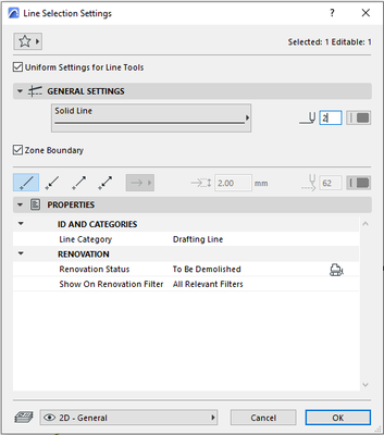

Are your elements Status set to "to be demolished" on purpose?
that will make everything dashed.

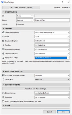

if you change the renovation filter to "06 No filters applied" that will fix it.
you will also need to update view sets if they have incorrect settings
OR
if you don't want these objects to be "to be demolished"(bulldozer), changeto existing(brick wall) or proposed(crane)

Scratch that--didn't realize I had a dashed graphic override on demo.
