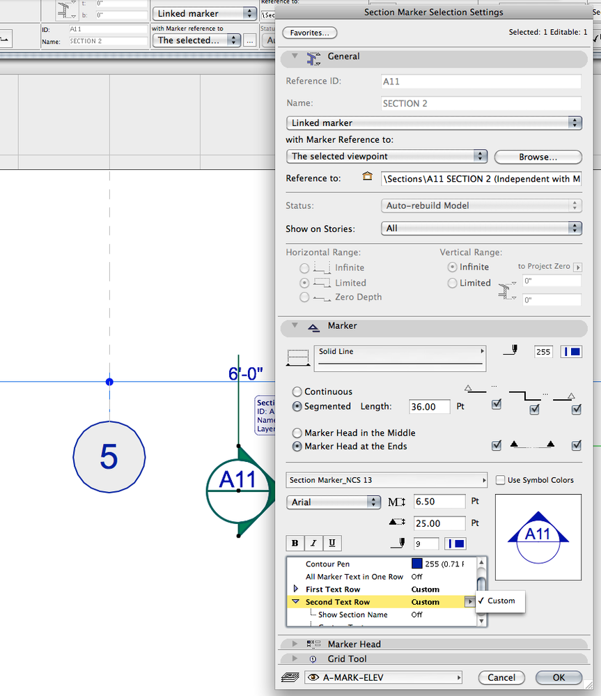

SOME HOW IN THIS FILE I AM NOT ABLE TO SHOW THE LAYOUT SHEET NUMBER IN MY SECTION MARKS ANY IDEA WHAT IS GOING ON? ....TKS.

In the screenshot you have attached, change the setting from custom to 'referred drawing'. Hope this helps.

Hi George, the thing is tat the only option I have to select is CUSTOM. (This is happening in this particular file only, in other files I have by default REFERRED DRAWING selected )
Hi Erika, did you attached a screen shot? Because I don't see any.

I think you need to change with Marker Reference to: from The selected viewpoint to The selected drawing. Your marker is referencing a viewpoint which cannot be on a layout (hence no reference IDs), you need to link the marker to a View that has been placed (or can be placed) on a layout. This is the difference between the Project Map and the View Map in the Navigator.
