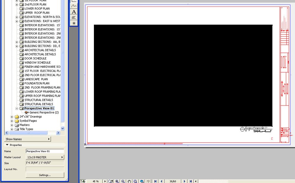

I can import 3D views rendered with ArchiCAD's Internal Engine but the 3D views rendered in OpenGL import into Plotmaker as solid black boxes--nothing showing.

Djordje, Link,
I haven't tried this to place an OpenGL 3D view in Plotmaker since these last posts. Now that I have a new machine up and running I thought that I'd give it a try again. I am still getting the solid black box where the drawing is placed. I tried it with everything else shut down and still no viewable image.
Is there anything else that I can do to get the OpenGL view to show in Plotmaker--a setting or something?
Thank you,
John
