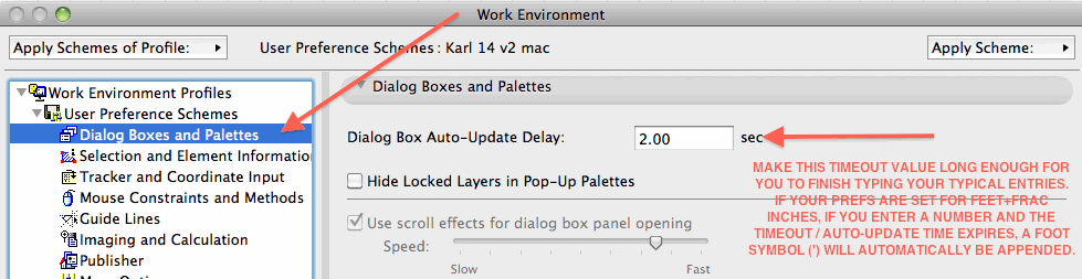

Karl Ottenstein
Moderator Emeritus
Attached image shows the Work Environment's auto-update / timeout value. The default of 1.5 seconds is too fast for most users I've trained. I'm a fast typist and find 2 seconds works for me. If you type slowly, make the time value longer.
Cheers,
Karl
AC 29 USA and earlier   •   hardware key   •   macOS Tahoe 26.5 MacBook Pro M2 Max 12CPU/30GPU cores, 32GB
That was it, for reasons unknown it had been changed to 0 seconds! No one in the office is confessing to be the author of the prank.
Thanks!
